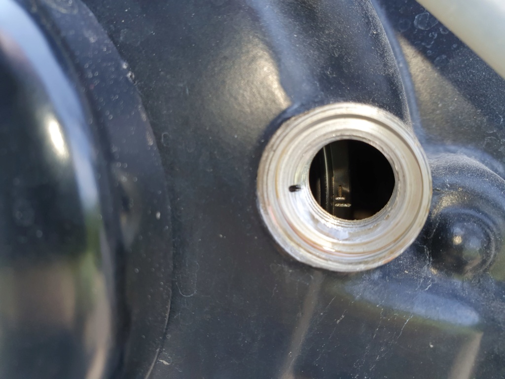

Today i will tried to check a valve clearance but when i turned the engine i saw that the timing marks are on position, but crankshaft mark are wrongBody vibrations SW-T 400 20200612

It would be amazing if the engine was running with the timings marks so far out of alignment. But who knows? some engines are more forgiving.
I would start by getting those timing marks lined up correctly.
(I remember some old ford car engines which would run (badly) with the plug leads connected in any random order!)

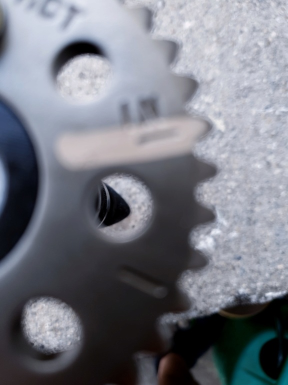

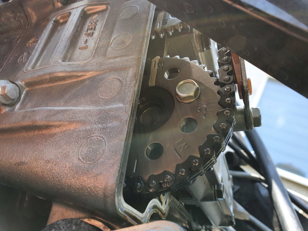

So today i disassembled the chain, I try to explain what i saw. Service manual told me that when i want to mounted intake camshaft and exhaust camshaft they must be set like in the picture from manual. Then marks are on the cylinder head level.
But in my engine is a little bit difference. If i set the sprocket on the marks then cams lobes are not facing in. my picture shows what i mean

You are dealing with a four stroke engine and that means the cams run at half the speed of the crank (the cams do one revolution for every two of the crank). If you rotate your crank one full revolution you will be able to get the cam lobes facing in like the manual.

Ok. But this it's when the chain is mounted. But now i have the chain disassembled. So the valves are closed and the pistons are in the highest position.Body vibrations SW-T 400 20200613
And for what is mark F on the flywheel?
Ok, so today i made a recognize of timing. When the mark T is on correct place, then cylinder "1" is in the compression mode and cylinder "2" is in the suction mode. But the cam lobes of cylinder "2" are in something between open intake and close exhaust. So when we try to the chain mounting it is nessesary to set the cams on the marks with cylinder head level. Because of course we can't have all valves close in one time. It was my mistake, but the service manual is not exact with this.
I hope it is clean for you what i want to say.

I'm sorry but I don't understand what you are asking here.
If the chain is out (I assume you mean removed) then there is no connection between the crank and cams so the cams can be in any orientation.
When the cams are reinstalled the crank should be on the T mark and the IN and EX marks aligned with the camcover surface and pointing inwards along with the #1 cam lobes. If you have removed the cam sprockets from the cams then these could be rotated 180 degrees so the IN and EX marks don't align with the #1 cam lobes.

I was thinkin that something is wrong with my cams, because the manual shows something different on picture. I know the sings have to be on the cylinder head surface. But i was thinking that the #2 cam lobes should be on 180 degrees rotated to #1, but they aren't.

I think you are going too far with all these engine issues.  If it's never been apart and timing chain is very close than a little wear is normal. Valve clearance check is good.
Front plastics do vibrate mostly on acceleration mine does.  Some are more sensitive to it and it's noisy sometimes.   Mine was getting worse found all the windshield screws were loose repaired that but still some vibration from front body parts.
That engine is in time. There are two a balance shafts in SW engine but it's gear driven from crank and unless it's been apart i don't see an issue.  ??

"As far as I can tell, the #1 cylinder is the left side so furtherest from the cam sprockets. "
I'm not sure of that. My three honda cars has always #1 cylinder close of cam sprockets.
But. Manual sad that when the chain was disassembled first we set the signs facing together. On my cams it's the cylinder close to chain. So for me this cylinder is #1

Your picture ........
Body vibrations SW-T 400 20200610
...it is not clear to me if that is two strokes (II) or a stroke & a timing mark (IT) ?
Stroke & timing mark are for valve timing
While
Two strokes are for counter balance timing
The different marks are 270 degrees apart (which is 1 1/2 turns of the crankshaft)
Possibly you are trying ti do valve timing on the wrong set of marks ?

PostSubject: Re: Body vibrations SW-T 400   Body vibrations SW-T 400 I_icon_minitimeMon Jun 15, 2020 6:34 am
Body vibrations SW-T 400 20200615Body vibrations SW-T 400 20200616
Maybe this pictures explain how the flywheel sings looks. I think that my IT is -| | ( T on the right side and | ). So i'm sure that i try to adjust the valves correct.

So, everything is done. Timing id ok and engine works fine. But vibrations are still. I think that it must be like this.

But, when i tested the vibratios that is even when plastic panels are disassembled. Side panels, seta, rear panel. So i'm sure that is not from panels.
