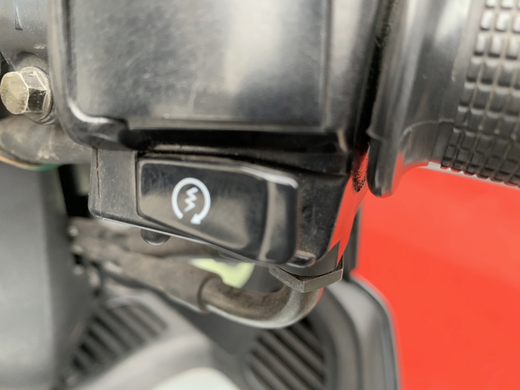

You are talking about this switch Tim ? (Picture enclose)

PostSubject: Re: Headlights off   Headlights off I_icon_minitimeThu Feb 27, 2020 9:34 am
Better with the file
Headlights off Db451310
Points : 10323
Headlights off Empty
PostSubject: Re: Headlights off   Headlights off I_icon_minitimeThu Feb 27, 2020 9:47 am
Yes, that switch. It has somewhat of a reputation for acting up.
