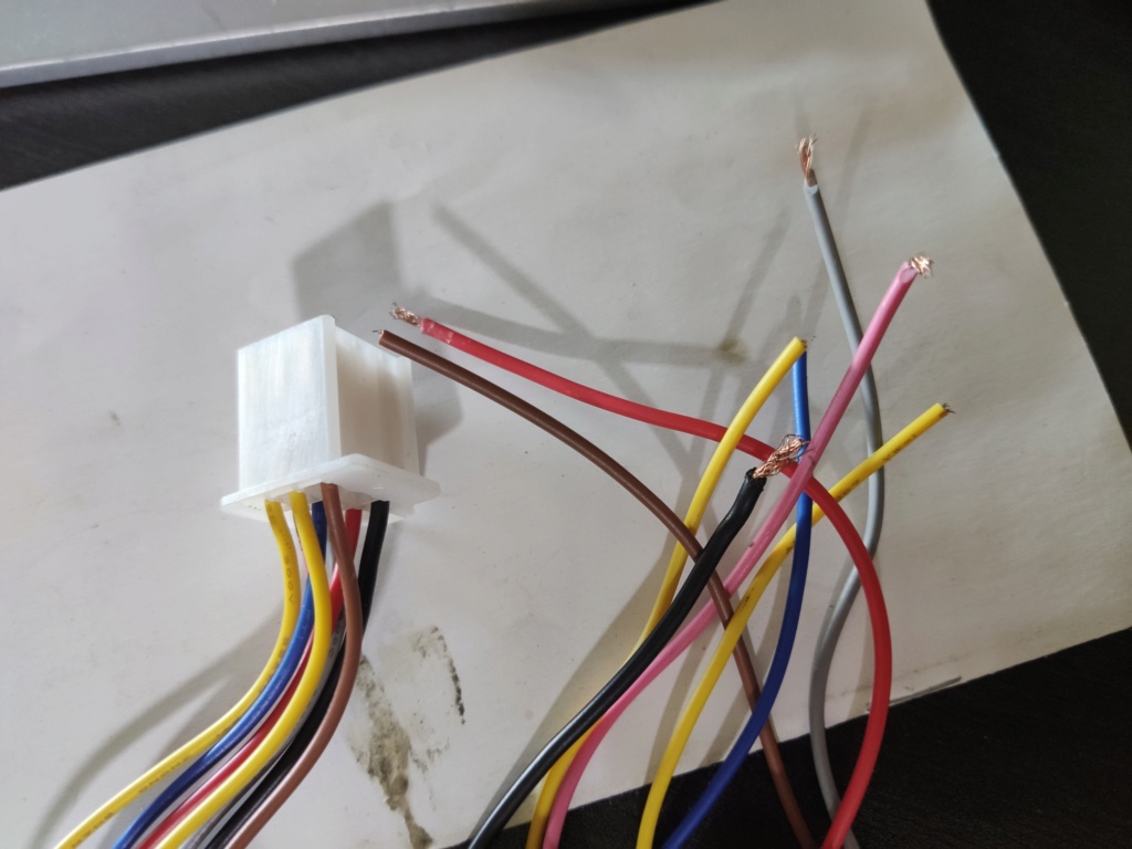

so i have had my silverwing for about 2 months now, this is my second scooter. my first scooter was a cheep taotao 50 cc scooter that i modded the hell out of until the engine eventually blew Shocked i had a 2 way alarm system with remote ignition on that scooter and i want to install that same alarm i took out on my silverwing. i have removed it from the old scooter already but for that scooter it was a simple 9 pin all i none plug in module that was easy to install. but for this bike it looks like i will have to manually wire it myself. now i was reading some stuff on this very same site briefly on alarms and how it can cause issues with the existing ignition protection that swings have. i dont want to go to crazy with remote ignition but i just want the very basics to work. the alarm is a universal alarm that works with any bike or scooter and comes with the manual wiring kit is well but i dont know where these correspond with the wiring harness or computer of the bike.
power
horn control
turn signals control
here's the wiring diagram on the alarm
Fitting a alarm on Swing? Img_2012
Fitting a alarm on Swing? Img_2010
Fitting a alarm on Swing? Img_2011

But what is “+ output”, “+ Start”, and “flameout”?

It is considered forum courtesy to introduce oneself first.
Hi Tim.
+ output will be switched live
+ Start  presumably will be ignition feed
flameout ??????? easiest there would be to leave the wire bridged as it looks like cutting is optional.
As to wiring it into the approriate places on the scooter, indicators are optional & a few moments with a voltmeter/multimeter will soon identify what's what for the rest

I had a very similar system installed on my wing 4 years or so ago. Everything works except for the remote disconnect - it is when you kill a bike if someone tries to drive off with it. I think that is your flameout.
Start is what goes to positive on your push start button
Out is what goes to your starter relay
I am sorry I cannot check it as my bike is stored quit far away this year.
Basically the overall installation was pretty easy and I am not an electrician.
Cheers,
Mad
