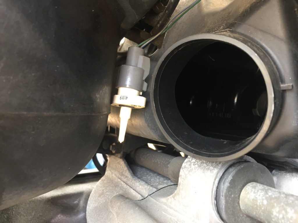

I just bought the Booster plug and installed it and it does make the bike run richer as I can see black soot in the tail pipe and on the baffle when I removed it from my Delkevic exhaust.
What I want to know is if I just removed the air sensor from the intake air box and blocked the hole it came out of and placed the sensor in a clean/cool air path of flow would it be the same as the sensor on the Booster Plug?
This is the air sensor in the airbox and where the Booster Plug is plugged inline with the sensor.
Booster Plug Img_3318
Booster Plug Img_3317
But if I was to move the air sensor into cool clean air wouldn't that be the same as installing the booster Plug with it's sensor also in cool air?

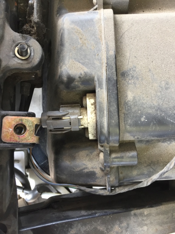

This is the actual Booster Plugs' sensor that I have next to the passenger peg mount.
Booster Plug Img_3320

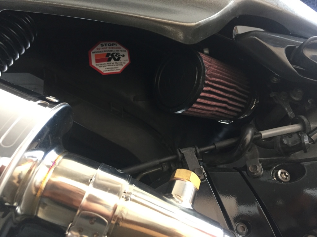

I also installed a K&N Pod filter with the Delkevic exhaust.

Since you’ve already purchased the Booster Plug, why not try relocating the IAT sensor? Whaddya got to lose? BTW there have been a couple of earlier discussions re Booster plugs / IAT sensor mods. Here is a link to one:
https://www.silverwing600.com/t10310-iat-sensor-modification-intake-air-temp-sensor?highlight=IAT+sensor
Does your Booster Plug replace the IAT sensor? If so, does it use the OEM wire harness plug and if not, how does it attach to the IAT wire harness?
Please let us know how your Booster Plug and IAT sensor experience plays out. We all benefit from shared information.

Yes I've read those threads, way over my head  Shocked  I needed a plug and play for my skills Razz
I'd like to try that but then I'd have to extend the OEM air sensor wires to relocate where I have the Booster Plug sensor.
It does not replace the sensor but goes inline with male and female plugs to plug into the OEM sensor(I didn't get a picture of that).
What about putting the OEM sensor into a hydro flask/bottle with ice to simulate and trick the sensor with cool air..LOL! Throwing that out for replies.

Your idea of an IAT sensor in a cold flask pretty much speaks to what that booster plug does: It’s a negative temperature coefficient (NTC) thermistor which operates at a lower temp range than the OEM IAT does.That NTC in combination with the IAT BS’s the system into delivering more fuel.
You could always add a switch to that Booster Plug wiring so that you could opt to turn it off and operate solely on the IAT when you wanted.
