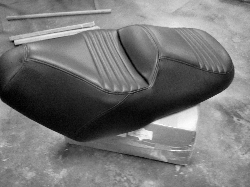

I did but the hard plastic guides or whatever they are doesn't feel the best. When I get the other stock seat I bought off ebay I'm going take my multi tool and take the drivers seating plastic back about 3-4" then replace the hole with aluminum and have it re-covered and see how that works. Did that on my Burgman and it was awesome.
Please post some photos of the steps you take to modify the seat.

PostSubject: Re: Seat pan mod by Kenny Joe   Seat pan mod by Kenny Joe I_icon_minitimeMon Apr 22, 2019 2:32 pm
Seat pan mod by Kenny Joe 06261410
Seat pan mod by Kenny Joe 06271410

Nice saddle. Is any of the foam the original shape? I can see that you've resculpted the butt rest, but did you also push that area back? Somehow I recall that the seat pan in butt rest area was was humped --but maybe I'm not remembering correctly.
It's convenient to have access to an air stapler so that you can restaple the cover to the pan. A hand staple gun just won't penetrate the pan.

PostSubject: Re: Seat pan mod by Kenny Joe   Seat pan mod by Kenny Joe I_icon_minitimeMon Apr 22, 2019 4:25 pm
Most of the original foam base was kept but I added almost 2 in of memory foam on the top. But I cut the plastic seat back 4 inches so it made for a super comfortable riding position with plenty of legroom.

That is one snazzy looking seat mod! I tried a simple re-cover on a Helix without the diamond tuck and it looked so crappy. You got crazy skills!

About all I can say about that seat is WOW! Great Job!
Hi Kenny,
Did you take some pics from the back side/ bottom? I would like to see how you’ve cut the plastic.

Me too. Cutting the seat pan can't be easy. Small air saw would work after drilling a starter hole. Is the front latch striker still here?
Very nice seat !!! cheers
Nicely done. Congrats!
