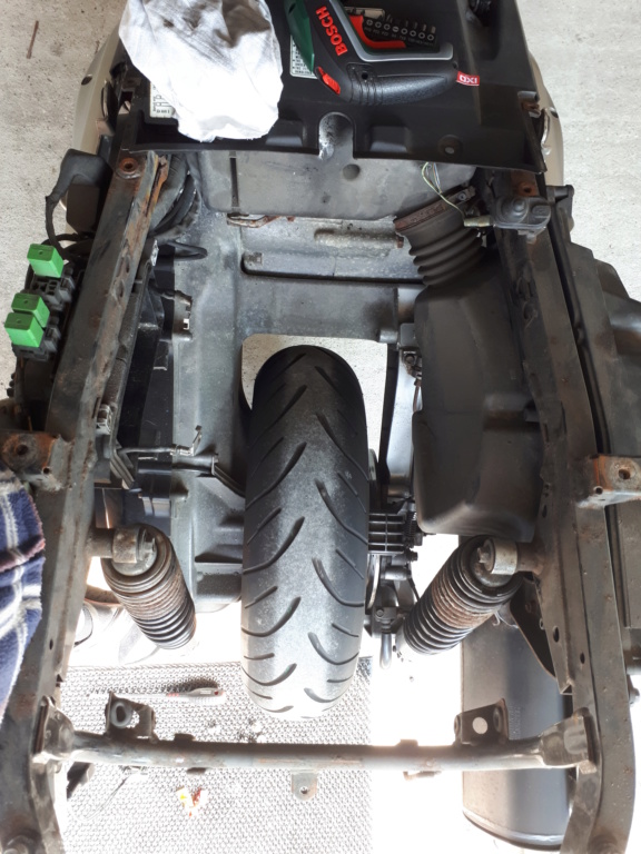

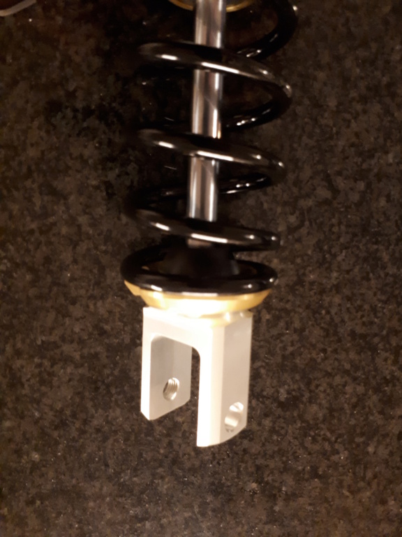

| YSS Shocks?? I've just bought a pair of YSS Eco Shocks, model number TE 302. The instruction manual tells me nothing about 'my' model of shock and the web isn't helping much. I include some pics of the shocks. I am guessing that the spring loading is done using the the gold rod to turn the spring collars on a thread and the allen key to lock in place.. I gather that one turn of the shock equates to 1mm movement up or down. Does anybody have any guidelines on the settings?,..they seem infinite. If it's a case of trial and error, I'm going to need a week off work to find the optimum setting, also, can there be a setting which copes with solo and pillion? If not, adjustment will require removal of the side panels every time I want to adjust for pillion and loaded riding....what have i done???    |
Number of posts : 1289 Location : Allentown PA. Points : 3793 Registration date : 2016-01-02
 | Subject: Re: Front and Rear Grief !!! Ouch. YSS Shocks ??? Fri Mar 29, 2019 6:20 pm | |
| No idea about ideal setting. Most likely you will be able to turn collars by hand on the center stand once lock is loosened. Trial and error. Hard to reach BUT find a spot with collars to tighten locks from inside area. Good luck.
Number of posts : 4189 Age : 79 Location : damn near Philadelphia, PA Points : 9654 Registration date : 2009-06-12
 | Subject: Re: Front and Rear Grief !!! Ouch. YSS Shocks ??? Sat Mar 30, 2019 6:15 am | |
| I suppose the idea is that first you measure the suspension sag on the scoot with the OEM shocks. Then you install the new YSS shocks, which as "supposed" to come pre set to OEM standards, and measure the suspension sag. From that point you fine tune the preload to your own preferences.
Any, yeah, given the task at hand, you are better off removing the side panels. At least for the initial set up. After that you can probably tweak the preload withoit removing the panels.
Please let us know how you get on with this. We all benefit from shared information. Here's a link. HTH
https://www.youtube.com/watch?v=TMDCEU98_9w |
Loosemarbles Silver Wing Guru
Number of posts : 1032 Location : South East England Points : 3287 Registration date : 2016-10-01
 | Subject: Re: Front and Rear Grief !!! Ouch. YSS Shocks ??? Sat Mar 30, 2019 1:58 pm | |
| Well, here's a sight you don't see very often.....  Or this.......  and this?  This is by far the most accessible way of reaching the shocks but I didn't do it for fun. I did in order to 'have a look' and also to do this....  I forgot to take pictures but basically, have a look at everything as you go. Don't force anything plastic and just go easy, figuring out what ought to come off next. You will be removing a fair amount of screws, nuts and bolts etc. so keep a record of their locations. This first bit is about gaining access to the shocks. Below I'll cover the shocks themselves. The last picture is the under seat bucket with access to the rear shock upper bolts. It ain't pretty but I'll make some blanking plates to keep the weather out and my stuff 'in'. It's a messy job so make a note of where all the screws, nuts and bolts came from. I actually found some mis-located screws where the previous owner had become confused. I've replaced them with the correct type. If you have the means to create these access holes in situ you will save yourself a lot of messing about if you want to change your shocks. For me, I wanted to 'have a look' anyway and see how all this stuff fits together. It's intriguing. One thing to watch for is the sissy bar/top box shelf fastening bolts. The two rearmost bolts thread into nuts which are 'loose', but they fall into an anchor well which keeps them in position. When you remove the metal frame which supports the rear fairing, they could fall out as you lift it off. I include a couple of pictures:   (As we all know when you drop a crutial, engineered, irreplaceable part, it manages to hit the ground, bounce out of view...it then, unbekwnown to it's owner, rolls off the driveway, bounces off the tyre of a passing car. Then richocet's off a neighbour's garden wall and tumbles along the street until it meets the nearest surface water drain and drops into the bowels of the earth, never to be seen again!) Another thing is the battery box. Looking into the under seat bucket, you will notice that there are two bolts visible near to the battery housing, (not the one which holds the battery cover on). You need to remove these to free it from the bucket but, there are two plastic 'grips' holding the battery cover to the floor of the bucket which need to be lifted gently upwards and outwards with a flat screwdriver or equivalent...be careful. It does work but be very careful not to snap anything. The battery box clips fit onto the bucket quite 'firmly'. Picture below:  The shocks? I took a punt. I removed the old ones then put on the new ones, from the box. I used one of the supplied washers on each top stub, greased it a little and then fed the new shock on. The bolts for the upper shock have a flanged washer type affair attached so no need for one of the supplied washers but a touch of grease is advised. I simply put back the bolt hand tight. I repeated the same for the other side. I torqued up the bolts later. As for the lower bolts, I did have to use a trolley jack to support the swinging arm during this process, in order to line up the bolt holes. As for adjustment, I will have to use trial and error. When I pushed the bike off the centre stand it didn't perform it's usual, 'graceful',fall to the ground with a slight bounce. Instead it hit the ground with a thud! I slackened off the spring tension and I've found a nice balance. The road test is still to come. BTW, I noticed a couple of clips missing from the inside of the side panels, so I put new ones on. (I had these in a small bag in the garage, I must have ordered them ages ago and forgot!). Pictures below:   I'll be glad to submit my road handling findings in due course.....
Last edited by Loosebearing on Tue Apr 02, 2019 10:49 am; edited 3 times in total |

| Loosebearing Once again thank you for sharing your experience it's definatley appreciated and of great interest |

| I've added some pictures to my article which you might like to see. I hope this is an insight to those who haven't explored their SW...yet... |

| - Loosebearing wrote:
- I did in order to 'have a look' and also to do this....
 Bugger, if I'd known what you had planned I'd have advised you, that other members (in the past) have found that, by careful measuring & calculation, that it's possible to access that fixing by drilling a 20mm hole (with a hole saw) which can then be plugged with a 20mm blind grommet (as used by electricians in 'adaptable boxes) |
