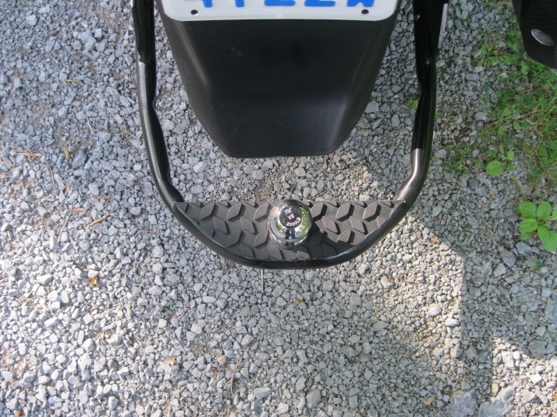

hotwingsI finally got around to building myself a hitch and trailer! It was a fun project. I think the hardest part was getting the correct bends on the 1" pipe for the hitch. The pipe was heavy wall (1/8")
and took a lot of elbow grease to shape. I used a hand bender to mold it and yes there was nashing of teeth! The plate steel is 1/4" for the ball mount and side mounts.
DennisB SW trailer hitchnl? Img_1611
DennisB SW trailer hitchnl? Img_1612
I wanted the trailer to sit low so i made the hitch to sit below the shock center by around 3". I replaced the original shock bolts with 1/4" longer bolts to allow for the extra thickness of the hitch mount. I also replaced the front bolt with a hardened bolt because of the sheer pressure that may come on it!
DennisB SW trailer hitchnl? Img_1613
I originally painted the hitch black but the area around the ball was easily scratched so i found this self adhesive rubber mat at walmart to solve that problem.
DennisB SW trailer hitchnl? Img_1614
The trailer was originally a Harbor Freight 4'x4' trailer. I cut and welded the pieces to the appropriate size i needed. The box came from Lowes. The trailer came in red but i painted it semi gloss black to better match the bike. The trailer came with all the lights and wiring, nothing extra was required except the Lowes cargo box. I like that the box came with a locking lid plus the ability to use an extra lock if required.
DennisB SW trailer hitchnl? Img_1615
I swapped all the trailer bulbs for led bulbs so the electrical system wouldnt be stressed.
DennisB SW trailer hitchnl? Img_1617
The bike required a 5 to 4 adapter for the trailer hook up. The adapter cost around $5 and was easy to install. I soldered the wires to the appropriate colored wires for safety's sake. Theres even a small area to pass the wire through without cutting/drilling the bike!

I road tested the trailer with my wife onboard for around 400klm's and i would say it pulls without effort! The only time i could feel it behind me was when making sharp turns i.e. traffic lights, parking lots etc. We took it on a road test fully loaded with two suitcases packed with 4 days clothing and footwear, plus a roadside emergency kit, plus two extra open face helmets in case the weather turned nice (cold and raining)......It didnt so we only overnighted and returned home the next day. We gave the trailer two thumbs up! excellent for touring around.

Nice job hotwings. I'm a wood guy (carpenter 45 years) and don't have any experience welding and bending pipe. But you put me on building stairs or a hip roof and I'm a pro. However, my son is a welder and can probably build me one. Any reason you chose to bend a pipe rather than cut and weld? Like I said, I know wood so forgive what may seem like a dumb question. Also, do you think that the bends in the pipe are as strong or stronger than welded joints?

I decided to bend the pipe rather than cut and weld because I think it looks a little more factory made rather than my bubblegum welds trying to connect pieces of pipe. If your son is a welder i think you would be fine welding the pipe, however an uncut pipe would be stronger. I bent my pipe with a manual rebar bender at work. The bender handles are 5 feet long and I still struggled to bend it. It was hard to get the pipe to stay on the same "plane", every bend would want to change the "flatness" of the hitch. With a little effort it can be done.
