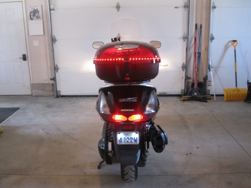

Got these strip lights on ebay for $3.09 and installed them on my topbox. I wired them into the running lights. They look really sharp at night.
cheap mods Img_1419

The lights are a nice safety addition!
