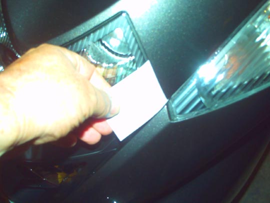

All,
Need your help.
I removed the 4 screws holding the upper panel for the windscreen. The panel will not come off. At the bottom I believe there are clips or something holding it in place.
Any help is appreciated on how to remove this.
I do not want to brake it, so, could use your help.
Thanks

After removing the 4 screws the garnish carefully slides off toward the head light.
https://www.silverwing600.com/pictorials-how-to-perform-maintenance-f21/givi-windshield-installation-pictorial-t46.htm

I tried to slide down towards the headlamp and blinkers, but it it rececessed and buts up against it.

Try using a plastic credit card to pry the garnish edge up and over as you slide the garnish down.

That worked, thank you.

DennisB,
Have another question.
There are 6 rubber washers. Do I need to remove 4 of them and place them over the metal bracket provided by Givi?
The metal brackets also have a white tape on them. Does this get removed or is it used to protect the bodywork>
Points : 8680
Givi AF214 - Windscreen panel removal help needed Empty
PostSubject: Re: Givi AF214 - Windscreen panel removal help needed   Givi AF214 - Windscreen panel removal help needed I_icon_minitimeWed Aug 25, 2010 10:21 pm
Those THREADED black rubber Gromets need to stay installed...BE VERY CAREFUL NOT TO PUSH ON THEM WHEN INSTALLING YOUR NEW SHIELD!!!!
Those rubber Gromets push through so easy and they cost so much to replace.
There has been allot of talk about the GIVI windshield install. Please do a search and you will find a bunch of good information.
