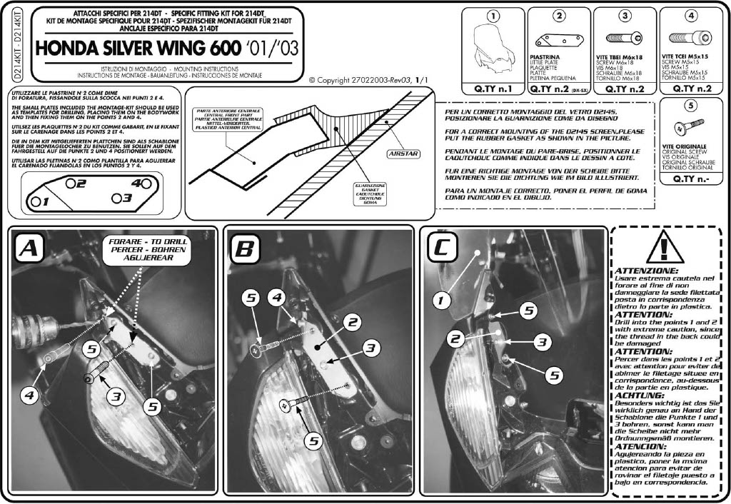

I also have the standard fixed Givi with the support set. I hope you got these, for just a couple of dollars you save your front connection.
Learning from previeus experiences I can only and strongly advice to buy these.
If I'm correct it's the D214 Kit
Here is the Givi URL; Givi D214 Kit
I could save my fearing just in time!
It also makes the screen less flexible on windy days.
Greetings from The Netherlands
Swing windscreen D214ki10
Swing windscreen Screen10
Swing windscreen Fbc1f710
