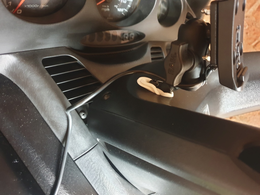

PostSubject: Re: SatNav M6 Ram Mount advice   SatNav M6 Ram Mount advice I_icon_minitimeWed 24 Jul 2019, 05:20
This is how I did it. I used this Ram mount with a metric screw that I had that was long enough to bring it tight to the plastic. I added enough washers that would fit into the hole but not let the Ram mount touch and/or crack the plastic. It's been a few years since I put it on and haven't had any problems with it. I can't remember if I used Loctite on it or not tho.
This is the one I used: https://mounts.factoryoutletstore.com/Category/CategoryListNoCache.aspx?category_id=0&autocomplete=true&search_term=RAM%20Mounts%20RAM%20Motorcycle%20Base%20with%209mm%20Hole%20and%201%20Inch%20Ball
SatNav M6 Ram Mount advice Ram110
SatNav M6 Ram Mount advice Ram210
SatNav M6 Ram Mount advice Ram310

PostSubject: Re: SatNav M6 Ram Mount advice   SatNav M6 Ram Mount advice I_icon_minitimeWed 24 Jul 2019, 05:37
Yup... perfect! Thanks Dale.. I think yours was exactly one of the ones I'd seen. It's obviously worked well!

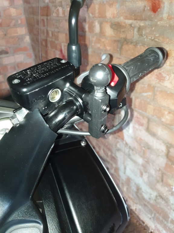

Update... been to the garage to do a couple of things, and since my Ram ball arrived this morning, I thought I'd have a little look...
Well... the thread's just too short!
It would have been perfect, but there just wasn't enough thread to reach the other side!
So. I've temporarily skipped to Plan C.
Couldn't fix the holder to my left hand side because the fitting for the heated grips remote is there..
So, I've mounted the supplied lever mount assembly to the right hand lever for the time being..
I think it's going to be too close to me for comfort as a permanent mounting position, so I'll order one of the angled ones that Dale used and ask them at the bike shop to fix it onto the central panel when they wire the electrics up...
They'll have all the various lengths of M6 screw with a bigger selection of washers than I could lay my hands on instantly!
Eh well. Worth a try...

Quick update:
After a few days waiting for a package of screws, washers etc, I got in touch with the seller on Ebay and they got a replacement set sent out straightaway. This arrived about half an hour ago, so I've just been down to the garage to see if anything fits..
I was a bit concerned when I looked at the sizes of the bits I'd ordered off Ebay, but then I remembered that things often look smaller in the hand than in a picture (at least, that's what my ex told me!)
The washers didn't look anything like wide enough but I shored things up with a few foam/plastic "washers" off the top of DVD-r spindles!
Anyhoo. It's on. The screw was plenty long enough, and the mount looks and feels secure, with a bit of shock absorption added by the foam/plastic rings.
It ain't pretty, but it works!
I took the handlebar mount off as well. I really wasn't happy with it on the rhs bar, plus it was too close to me and too far off my line of sight.

SatNav M6 Ram Mount advice 20190810
SatNav M6 Ram Mount advice 20190811
