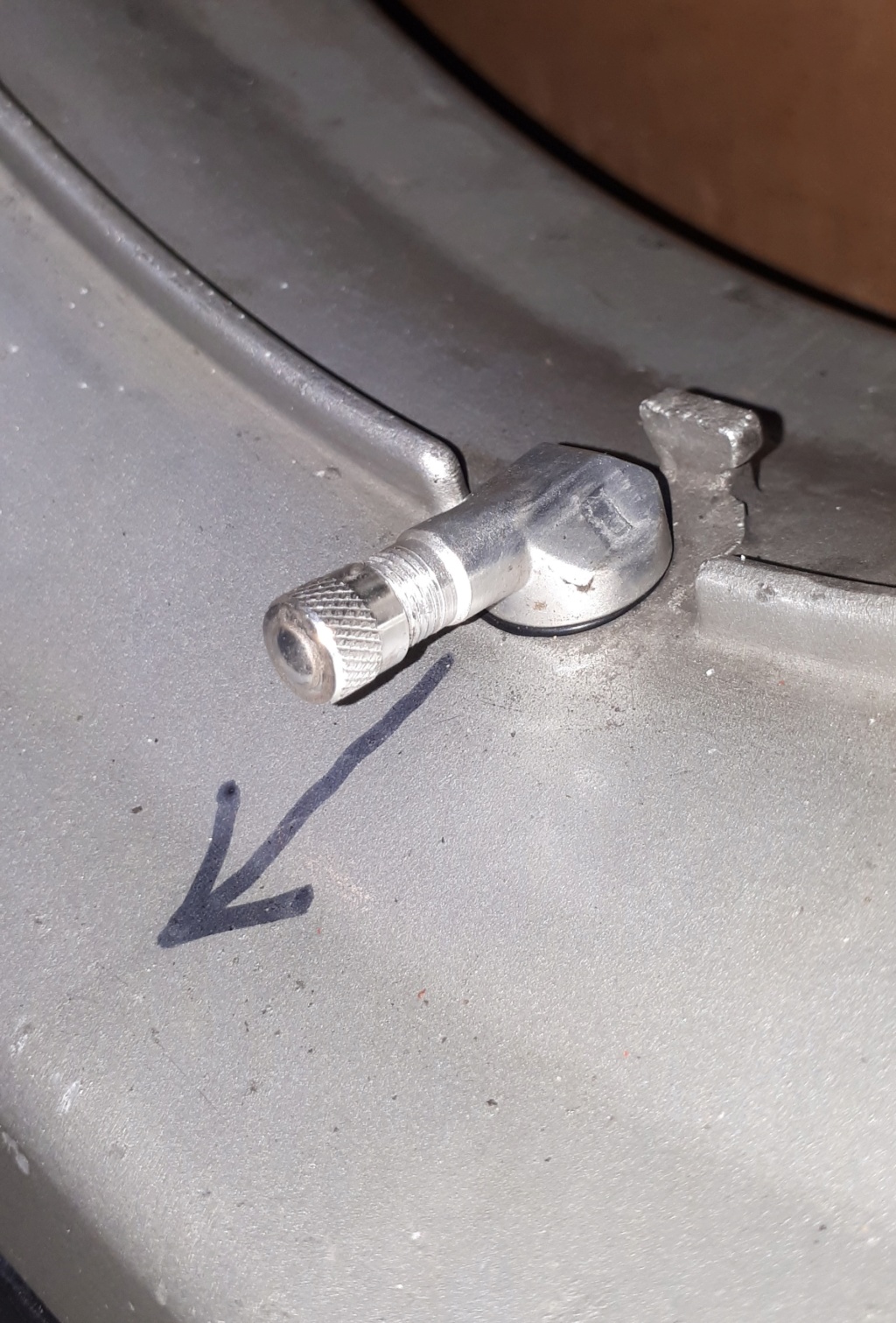

PostSubject: Re: Tire valve help   Tire valve help I_icon_minitimeThu Jan 09, 2020 2:55 pm
Tire valve help New_ty10
Well, here's my new tyre valve.
Thankfully it wasn't a puncture letting all the air out, it was due to corrosion around the valve hole. The guy at the shop gave the orifice a good clean up (my Doctor tells me that all orifices can benefit from a good clean up, especially with a wire brush!). The tyre guy also commented on how well this new valve fitted against the rim, both inside and outside. He pressure tested it and all seems well.
BTW, I drew the arrow on the rim to make sure he fitted it the right way round but then realised it could only fit one way round, pointing to the left (as you sit on the bike).
I have yet to see how it behaves.  What a Face

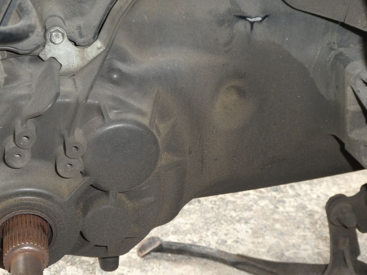

PostSubject: Re: Tire valve help   Tire valve help I_icon_minitimeFri Jan 10, 2020 11:57 am
If you've ever wondered why people urge caution when fitting right angled tyre valves on the rear wheel which point to the left, have a look at this...look close, there's about 2mm clearance between the valve cap and the drive casing. Boy, was I lucky.....damn sight easier to check pressure and inflate though...phew!  Shocked

PostSubject: Re: Tire valve help   Tire valve help I_icon_minitimeFri Jan 10, 2020 7:14 pm
what is that? tansmission casing from behind?
MINE LOOKED THAT WAY AND SOMETHING WAS SCRATCHING BEFORE sorry capslock
Tire valve help Rei10
but if there is something in the way ther is always the dremel to remove a few mm
OR IF POSSIBLE A SHORTER VALVE CAP.

Number of posts : 1327
Points : 4065
Tire valve help Empty
PostSubject: Re: Tire valve help   Tire valve help I_icon_minitimeFri Jan 10, 2020 8:30 pm
You also have some rusty drive splines there a little moly paste for lube works great.
Mine to the right no issues there except the brake disc.

PostSubject: Re: Tire valve help   Tire valve help I_icon_minitimeFri Jan 10, 2020 11:53 pm
Tire valve help New_ty12
When comparing Sepp's photo, it looks like someone has removed some metal from your rear end to make room for the valve stem clearance. I hope that I am wrong.
Looking at the photo again, it may just be the angle of your photo. Possibly just the reinforcement ridges that your valve cap gets close too.

Points : 4026
PostSubject: Re: Tire valve help   Tire valve help I_icon_minitimeSat Jan 11, 2020 5:04 am
That's 'normal' bud, did mine years back & took the same picture .....
Tire valve help Dscn3010_800x600
..... I also had to grind a small area on one of the casing support ribs for clearance ( there's a picture on here somewhere iirc)
I would reccomend replacing the alloy valve cap with a plastic one before water & road salt get into the threads & corrode the cap on, apparently after that happens it's a bugger to remove.
PostSubject: Re: Tire valve help   Tire valve help I_icon_minitimeSat Jan 11, 2020 12:38 pm
nah, if you look at my photo where the round thing (ballbearing mount for reduction gear) is next to the 4 screw holes. you see the valve is in that area on the other mounted wheel picture.
maybe something stuck to the top side of the tire or an adventure from a previous owner.
...and yes , next tire change I will clean up that rust, this time I was just too lazy.
