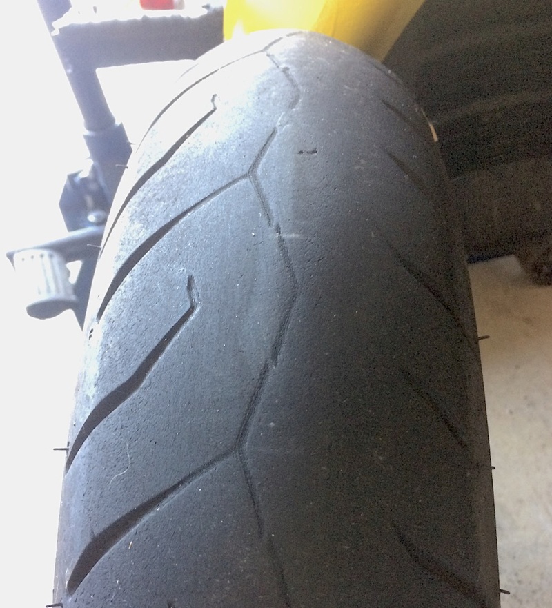

|  Took the wheels of my Silverwing, going to have the tires removed and the rims powdercoated this week and I noticed this wear pattern on the front wheel. The right side with more wear is the brake side, is that normal? Has anyone else encountered this or have thoughts? |

| In country's where you drive on right side of the road most front tires wear uneven on the left side due to the crown of the road. |

| Getting the answer isn't a waste  the crown of the road and left hand curves will do that. |

| It does however mean you are cornering with sufficient enthusiasm :-) But allowing it to wear that much is a bit silly, you need enough tread to clear water when it rains. A skid from the back you can usually manage, a skid from the front usually means a crash. Always change the front tyre early. |

| I would be concerned about that degree of uneven wear. I have seen front tires showing slightly more wear on one side but never to that extent. |
