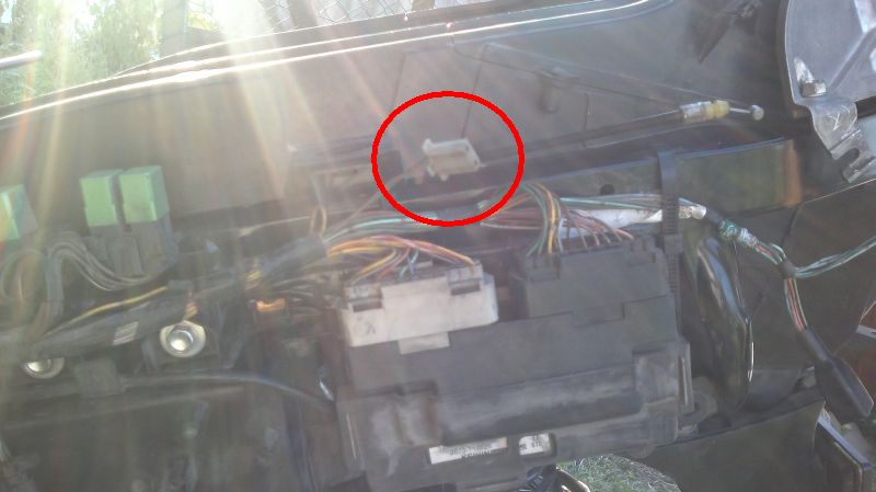

| Hi, I'm new to Silverwing and have a FJS600 '02 now. I had to undress it to do some repair and maintenance, and found this free connector by the ECU unit. Can you tell me its function?  |

| Hello Peter. Welcome to the forum.
That connector terminal is for a jumper wire (brown to green) so that a PGM-FI code(s) can be read via the FI display light. You'll need access to a FSM (Factory Service Manual) to decipher the FI display light flashes.
Unless you are experiencing fuel or performance problems you can pretty much ignore that connector.
Tim |

| Thank you Tim, so in this case I don't look for its hidden pair. |
