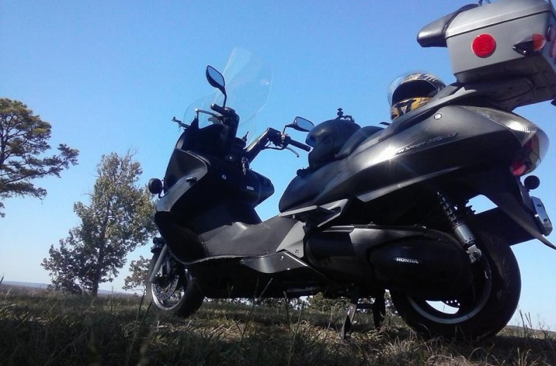

had my SW 600 for 5 Mons now and 6,000 miles later ive added  a luggage box/back rest, wider foot pads for both me and the passenger, 135 db air horn, 2 added sets of driving lights. cut down 6-8 inches off the Givi add on windshield,
1] Windshield was to tall when raining could not see the road,
2] Had that same model Lugbox/Back rest on my 2 reflex scoots wife loves it.
3] Added 2 sets of lights am a Meteor coming down the road,
4] Added 135 db air horn,
5] added wider foot pads, feet are like ducks and kept trying to slide off the side, wife hates the pegs so added a pad for her,
6] 6,000 miles on a new scooter tire so went DS,[will see what this tire does]
7] Go Pro cam mounts
you can tell i love to ride Arkansas, 6,000 miles in 5 mons. Getting 50-60 MPG, using 93 octane no ethanol.

Very interesting scoot and mods. What did you use for the leg shields? It kind of looks like some thick rubber with a fabric base --like the inside of a tire. Pop-riveted on?
What brand/size darkside did you use?
Where & how did you mount the top set of driving lights?

Joyroad TOUR RX1 165/70 R13 79T TL [now have 200 miles on the tire and zero issues, matter of fact it feels better than a normal bike tire]
lights mounted beside air intake with screws, lower lights where the reflectors were. wires went through the air intake.
for Power i ran 12 g braided wire direct from battery through an add on 20 amp breaker added a toggle switch on the dash, and a 2nd horn button by the current horn button.
the footpads are made from mud flaps for tractor trailers, 1/2 inch thick and non skid, i removed the plastic and drilled and then bolted a 8x16 inch galvanized sheet metal the the scoot frame, the used self taping screws for the mat.

Question on the lights that were mounted where the reflectors were, have you had any problems with them shaking? I mounted my Cree lights there and I haven't had a chance to see if mine shake or are effected by the front end mounting.
no shake. i do like that loc as your lights point where ya steering.

Did you use some type of reinforcing plate inside the front cover to attach the light bracket? I know you said that the lights are "generic", but do they have plastic bodies and plastic lenses? I'd be concerned that heavier (metal body) -even small 2 -2 1/2"- lights would cause the tupperware to crack and split. And if plastic body and plastic lenses (like Walmart 'Blasters'), doesn't the LED bulb kick out enought heat to melt the light? Given the fixed position of the mount bracket are the lights adjustible for up/down? Or did you pre aim the lights before you drilled into the tupperware?
Sorry for the amount of questions, but I don't want to drill into the front cover to mount lights then find out, "Oops! That was a mistake"

the lights are adjustable left and right,  and up and down if you loosen the mount screws, the bracket has adjustable slots, i used self tapping screws so that the plastic won't have any fatigue issues, carefull when ya use em go slow.  also another option if you have small hands/arms   that loc you can reach under and hold a nut of you prefer to use bolt and nut.
