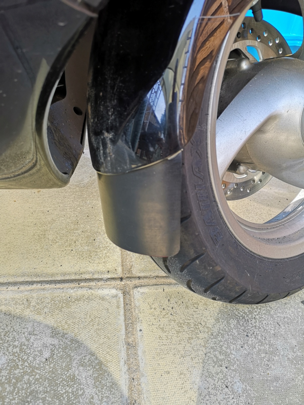

PostSubject: Re: fender extender   fender extender I_icon_minitimeSun Aug 11, 2019 2:01 am
Done mine in a similar way earlier this year when I got the Swing, I had some old rubber matting cut a shape out, took off & cleaned under the front mudguard, stuck the flap with "No more nails" and job done. Easy to do and helps stop the crud getting in the radiator.
Kev
fender extender Img_2068
fender extender Img_2069

PostSubject: Re: fender extender   fender extender I_icon_minitimeSun Aug 11, 2019 11:28 am
Thanks guys, it's next on my list too. Goonerkev has done a neat job. The reason I thought of going for the CB500 type was for an easy option. If it has the correct curvature and is a simple case of cutting the top off, then it sounds like the simplest method. I'll give a some more thought...
