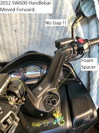

" I feel the bars are a bit too low and a bit too close "
I had same issue when I got my SW, I rotated my bars fwd. some on the holder clamps, it actually raised and moved them fwd. I can say/remember exactly how much, but it was limited by how the plastic cover fit and mirrors hitting windshield at full turn, etc., but it really made a difference.
In all honesty, it was not that simple, it required fair amount of fiddling/readjusting/repositioning of handlebar cover, mirrors and controls, etc. I actually had to tweak/bend the handlebar cover bracket, add washers, make a foam rubber spacer over key ring, install a few zip-ties, etc., etc. in an effort to best position cover, but KIM that the gap between dash and handlebar cover will increase, no way around it. A picture may help ..

I doubt there are any aftermarket bars that would fit due to the bend and plastic covers would have to be removed. Foward yeah but with any kind of larger windshield there is not much clearance at full lock.
Mirror extenders work great on this bike but that is just another issue.
