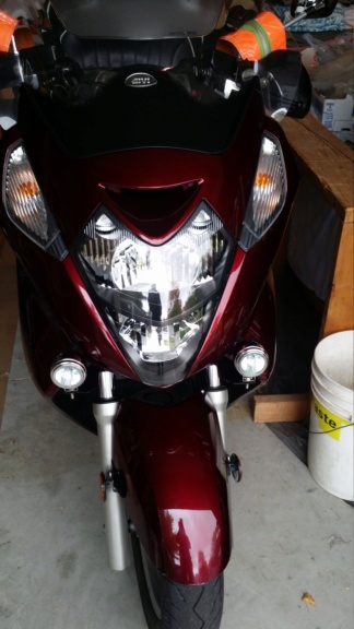

I talked with Cathy and also tapped into Bob's expertise.  Very helpful.  I did purchase one of DennisB's mounts a few year's back and in fact, I also bought a pair of the Optronics QH87CD (Walmart) he suggested using.  They are decent halogen floods for the price but not what I need/want for me.
They are shown in the pics below mounted on my latest SWing project ... mostly for positioning and sizing.  They are 3-1/8" (80mm) tall by 2-7/16" (60mm) deep.  Close to the maximum size that can be used with Dennis' mounting bracket unless you want to mount them upside down which I do not.
As you can see, I've had them temporarily mounted but they've never been wired up to my SWing as I could tell from my trial "night test" against the garage door they were not what I need/want.

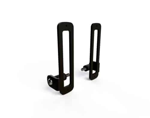

The difficult part was attaching the offset mount.  The plan was to attach the mount to a corner braccket.  First, the bracket needed to be bent an angle that would prevent the fender from being scraped.  Found that out the hard way.....  It took a bit but I finally got it.
However, I later learned that there is an fender mount option and Twisted Throttle does have the kit. The job would have went much more smoothly and no scratch the fender worries with those.
Denali DLR Light Pods Denali10
You can see that the Fender Mount can be inserted in place of the Swing reflectors.  So much easier  Rolling Eyes

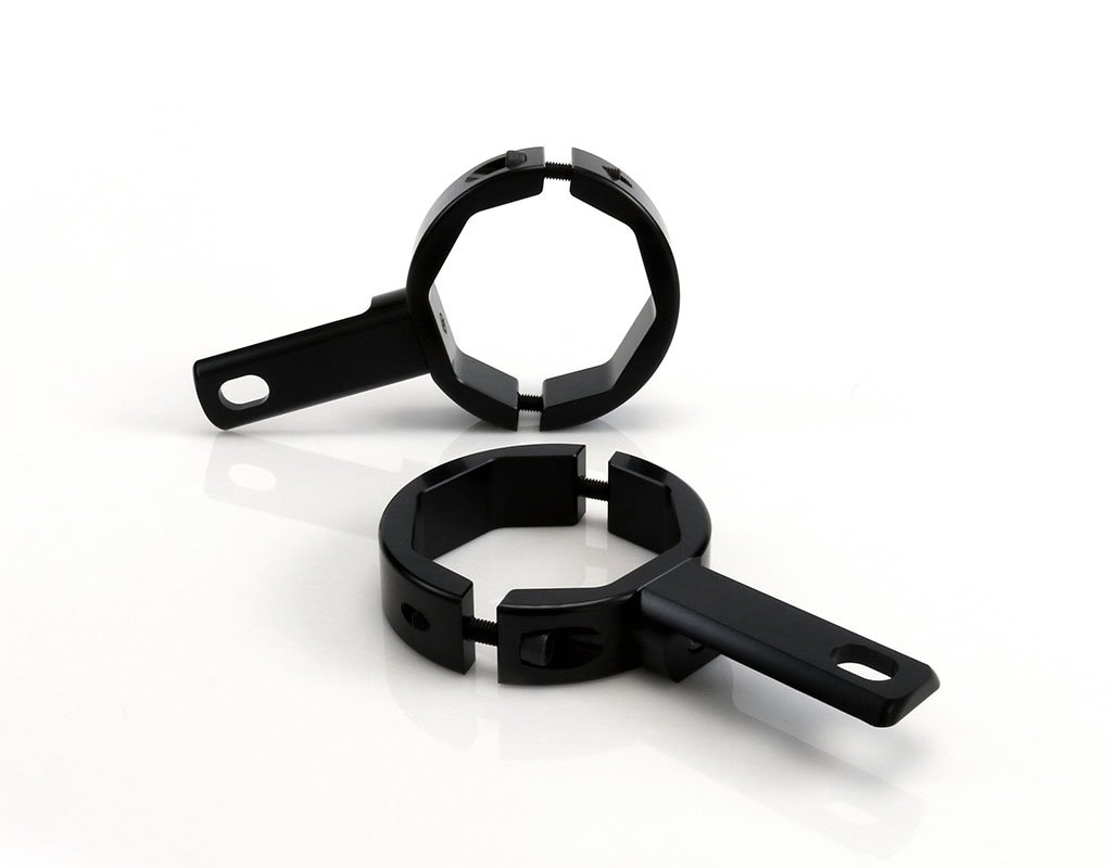

FYI the Denali website offers reticulating Bar clamps, for those who want to mount lighting to. They offer four Sizes runing from 21mm-29mm up to 50mm-60mm.  They're pricey but seems that be much easier to attach to Swing shock than working with a light bar.  Just a thought  study
Denali DLR Light Pods Articu10
