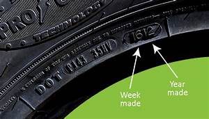

| Welcome. Many happy S-miles are ahead for you. Vibration could be a tire issue or balance. Most dealers can't balance a SW wheel are there weights on it? Tire age is easy to check.  Look for this on sidewall either side. 16 week made 12 year made. Even a new tire could be 2-3 years old before it's sold. |

| I did see 1 weight on the tire. Pressure was low, so I aired up. I'll check the tire date soon to be sure. Had a nice ride after work today... loving it! (And my wife loves it too  ) |
