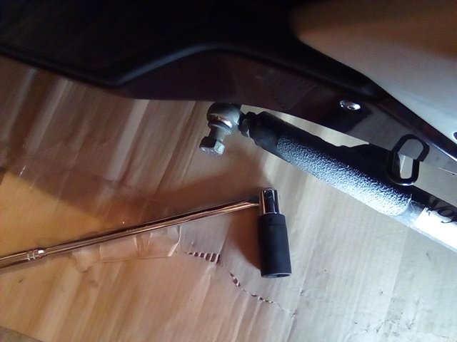

Glad to hear you were able to rescue yourself. Any chance you can post a photo of the slider and its location. It may help some one else later on.

I will take some pictures when I do the adjustments. We made it back to Couer d'Alene. Resting the rest of the day.

Ok we are finally back in Coeur d'Alene Idaho after traveling about 1025 miles. While we were visiting Moses Lake WA, a piece of my trike fell off and we were lucky to have found it in the Walmart parking lot. The slider allows movement of the trike's suspension system when going over bumps in the road.
To remove the trike:
1- Tie off the bike.
2- Disconnect electrical for fender lights.
3- Remove main plate bolts.
4- Slide trike backward.
To adjust slider:
1- Loosen lock nut.
2- Turn slider clockwise to shorten the slide, or
     Turn slider counter clockwise to lengthen the slide.
      (I made length same as the other side)
Reinstall trike:
1- Slip the sliders into the receivers
2- Bolt trike frame to to main plate (80ftlb)
    Don't forget the spacer and lock washer.
3- Reconnect electrical.
4- Tighten lock nut on adjusted slider.
You are done.
My journey through Western Canada Adjust10
Adjusted slider and receiver.
My journey through Western Canada Main_p10
Bolt trike to main mounting plate.
