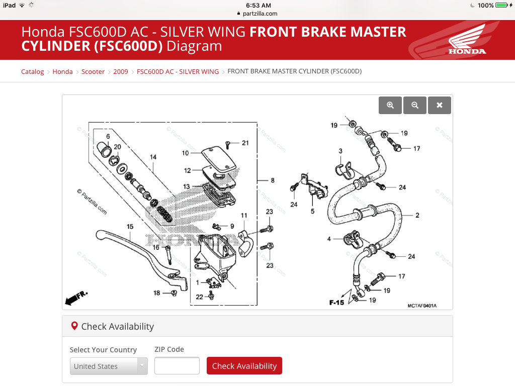

I'm curious about that "small stainless steel piece next to the drain hole". Can you identify that piece from this parts illustration?

# 9 ? That little piece of metal prevents a big mess when releasing the lever with cap off. If it wasn't there brake fluid would shoot up about a foot high. My FJR doesn't have these and you must release lever slowly or it's a mess'

Tim,
It does look like #9 in the illustration.

I made an error in post from Sept 15th. The little piece of metal in the brake master cylinder stops the fluid from shooting up when the lever is pulled not released.
Bleeding the clutch and brakes on FJR today discovered my error. Rolling Eyes
