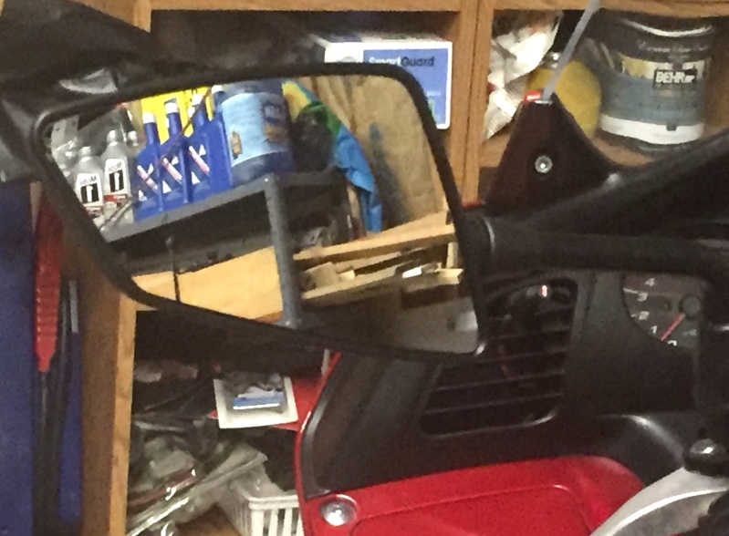

As many have stated, stock mirrors on Swing don't seem to reach out enough. One solution is mirror extenders easily found on eBay.
I purchased a set of these but ended up finding a set of mirrors on eBay that had a longer arm without the need for the extenders.  Shipped from Taiwan in 5 days and the seller provided excellent service, nicely packaged and product looks as well made as stock mirrors so far. Seller also has other styles and shapes if these don't have look you want.  Many have nice images of dimensions so you can see if they will be right size and reach.
Magazi Hawk Mirrors
Photo shows the reach difference of the stock vs the replacement mirror.
Mirrors with longer arm Fullsi12
Mirrors with longer arm Fullsi13

Have you tried them yet at speed, I have found with after market mirrors they vibrate much more than the genuine ones.
I was on a site yesterday and someone had fitted Burgman (must wash my mouth out now) mirrors to their SW they are wider and fit straight on.
Be interested to see how yours perform.

I rode into work this morning and I didn't notice any issued but it was dark and a bit wet from rain and barely a car to see in the mirrors so I didn't get going as fast as normal and didn't have much to use them for.  I'll see how they work on the way home in the light and moving faster.  The mounting bolt is longer than the OEM, so they fit tight in mount and they have a rubber boot that slides over the mount as well.

Rode home from work in daylight and at speeds up to 55MPH, no vibration, needed to get used to teh shape and make some final adjustments but they do extend out farther and do not get blocked by my arms as the OEM Honda ones, the extra inch or so give just enough extension for my needs.  Will see how they hold up over time, I always have the OEM ones to go back to with the extensions if needed.
