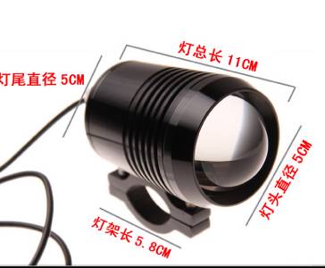

| We have a few members in our local riding group that have taken a modified version of the DennisB light bar and beside having two LED lights that are always on for conspicuously added two more switched LED lights in the middle of the light bar. We have over half a dozen people with Silverwings in the group and a few times people have had their headlights stop working at night. All but one just needed to clean the starter switch and one had to replace the switch. Two of these are brighter/whiter than the stock headlights but with four bright LEDs there's more light available than you'll ever need. These are the LEDs we've been using. They work great and are the lowest price CREE LEDs I've found. Here's a link if you're interested in them. |

| Wow, nice lights. And at a great price too. Any idea how much one of them might weigh?
I had a set of Denali LEDs on a Dennis bar but, even though they were just about the same size as these lights, they were too heavy for the bar and, in the end, were too bouncy.
There seem to be any number of good aux lights out there, but the problem is; where to mount them? Mounting lights on the forks seems okay for being seen by oncoming traffic, but not for serious night riding. Night vision lights need to be mounted high to be effective --eye level would be ideal, but...
It's a shame that some Imagineer can't conjure up a light bar mount that is supported by the front fairing bolts (where the Dennis bar mounts) and those large hex bolts that secure the upper fairing near the headlight; vertical bars running up the side with at horizonal bar joining them in the middle. Like a big letter "H".

| Tim I'll get the weight of one for you later. Since DennisB is no longer available to buy his light bar from we've been having them made at a local scooter shop. They are pretty simple to make if you have a welder available. As I said above a few people have four of the lights mounted on a modified light bar by just adding two more small "legs" to the center of the light bar. I've not noticed any bouncing of the lights and I always ride second in line so I can see the others that have them in my mirrors. If I can get someone to get pictures of the setup I'll post them here. |

| First let me answer the question Tim asked about the lights I posted at the top, they are about 200 grams each. That sounds heavy, I was surprised but that's what they are. I haven't noticed any vibration on any of scooters using them, even those using four of them. Tim do you know what the Denali LEDs weigh? I still don't have pictures but when I do I'll post them. That brand looks interesting too hotwings, and they say they are 30W. It's interesting they have three different modes, high, low, and flashing. I'd like to see them in person to see what they mean by "Unique square spot suitable for pavement". That price is for one light only not a pair,I'm sure you saw that but I thought mention it. The price starts to climb when you start adding mounting brackets, but here is a different seller that is selling them $4.20 cheaper. They also appear to be a more stable or at least larger dealer, although their name is "snakewang". 30W LED Fog Spot Head Light |

| Those Denali lights weigh 12.8 oz each. Off hand I don't know what that equate to in grams. |

| 12.8 ounces is 362.87 grams. What did you do with the Denali lights? I'd really like to have a set to compare them. I think I'd add them in between the ones I have and have them switched separate from the headlights. The ones I have come on with the headlights so they are on day and night. |
