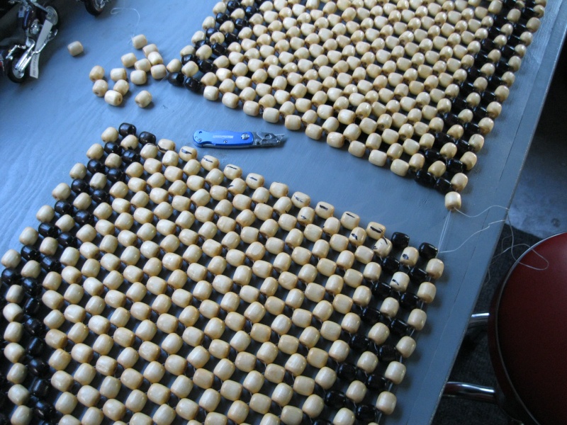

After about an hour of riding, my wife and i would have to stop for a five minute break due to monkey butt. I always wanted to get the airhawk seat cushions but at $200 for 2 i held off. Tarmacburner (thanks Tarmie) posted a link on a post a couple weeks ago about a company that made beaded seat covers for motorcycles. Their covers were roughly $50 plus shipping for 1, so i got thinking, i could do that Wink. A trip to the hardware store and i found a beaded car seat cover for $14.99. Before cutting anything we took it for a test ride so i could return it if it didnt help. After a couple hour ride we both gave it thumbs up. Yesterday i went alone on the finished product and 3 and a half hours later was more than happy with this new cure. While riding its easy to move slightly and relieve any pressure. Just sitting on the oem non beaded seat it didnt seem to matter which way i shifted i could not stop the onslaught of monkey butt.
$14.99
I marked roughly where the cut should be for the front and back part of the seat.
Cutting one string only allowed one row of beads to be removed. Thankfully the whole thing wont unravel.
I slowly and carefully cut the appropriate strings to get close to the required shape on the corners.  I had to reweave the string wherever i thought was best and retying where required.

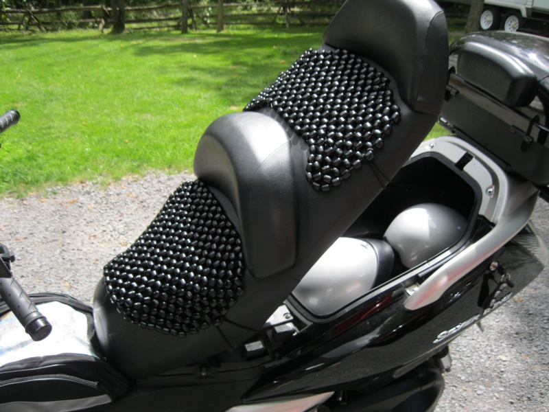

I had this much of the original seat cover left over.
Making sure it fits before painting.
I painted around 4 coats of satin black using a good quality spray paint.

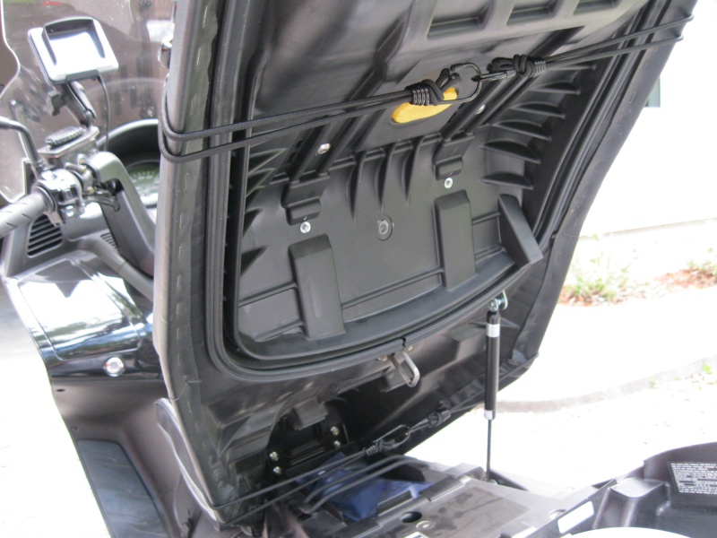

I got about 10 feet of 3/16" black stretch cord to make the four straps required. I didnt want to use one piece bungee cord because i was afraid the steel clip on the end would eventually damage the seat where it connects to the beads.

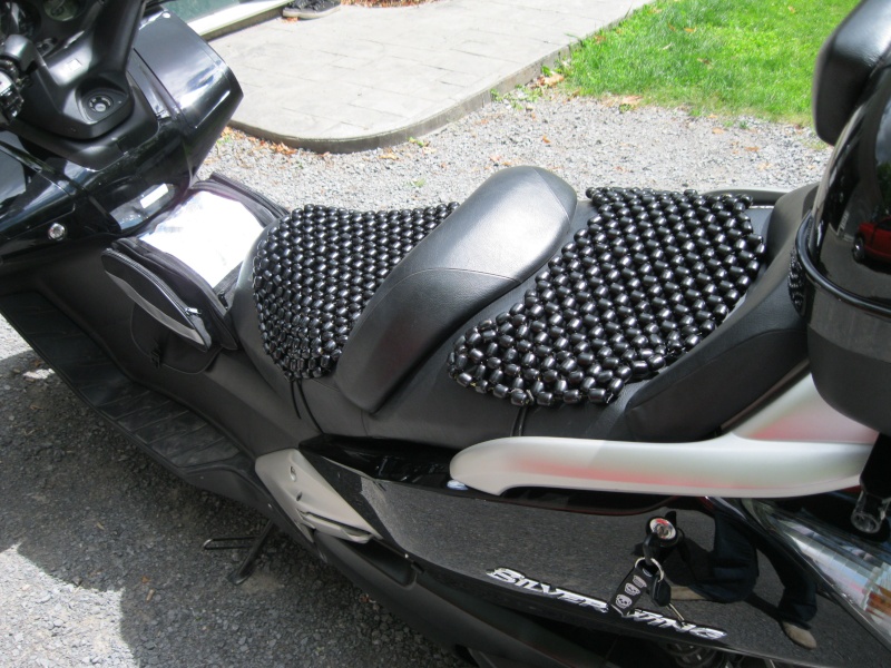

Finished and installed.
They stay in place when the seat is opened. The seat strut is not affected by the small amount of extra weight.
The stretch cords hook underneath the seat. It doesnt affect the seat latches. With the hooks under the seat it stops someone from doing a quick grab and run with my prized monkey butt cure. Laughing

Very nice Hotwings - thanks for sharing! I noticed that for the rider you extended the beads over the sides of the seat - rather than just having beads on the flat seat surface. Do you like them better over the sides now that you have tested your seat - or is having them just on the flat surface better? Also, if anyone has found a bead seat in the states that is the equivalent -
let us know. I use an Airhawk - that I like for cushion. Will the bead seat give me cushion or would I would need to combine it with a gel mat? I like the Airhawk - except that I tend to move laterally in the twisties on the Airhawk as I am suspended in a bit of air.

 The beads are hanging a little over the front due to the fact that it was the factory shape of the original bead cover and i wanted to keep my "messin" with the strings to a minimum. I dont think it makes a difference if its hanging over or not because of little contact in that area.

A factory set of Beadriders hang over the front of our Burgman seat, doesnt bother anything. Did a 200 miler today on Angeles Crest Hwy, great riide, never heard one "my butt is sore" today, oh, I think I may have said that, time to make one for me.

Well that was easy - and it's very comfortable.  Smile
The trickiest part was deciding which of the lattice of nylon threads to cut so that it didn't unravel. Once I worked that out, the rest was straightforward. I didn't need to shape the back end as my bum stop is a raised back rest, under which it tucks. I ran some black whipcord around the outside and put a spot of glue on all of the re-tied knots, just for bit of added strength.
Instead of the elastic cord under the seat, I threaded a black boot lace through the beads at the back, ran it around the back rest brackets and tied it behind. That allows me to lift it off the seat, should it need wiping after rain. Even without tying, I don't think it would slip, but as said, it might hinder the light-fingered from "doing a runner" with it.
I bought the "negative" version, ie mostly black with light coloured lines, so I probably won't paint it, but I may add a coat of varnish/lacquer.
The original is long enough to make two, which makes it somewhat cheaper than buying ready made, and a whole lot more fun!
Now, does anybody know what to do with hundred or so loose wooden beads!!!

Now I'm looking at the picture where you indicated that by cutting one string only one row unravels if I'm looking at it correctly - will think about that for a while.

RickV. Cut the thread in the centre of the mat, rather than the edge and a couple of rows back from where you want the mat to finish.
Then you'll (a) have longer "tails" at the sides for tying knots, and (b) if you make a mistake, you have another chance on the next row.
Leave to last the cutting of the threads that run around the outside.
