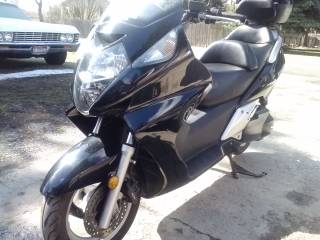

pics from the ad:
you can't really see it, but I'll be looking for a new heat shield for muffler
[i]
