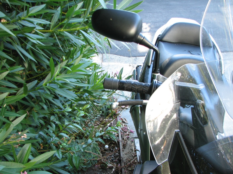

Got some 1-1/4 copper tube fittings and some lead fishing weights and made 18oz bar end weights x 1.9 inch long. They do not stick out much past the end ball on my brake levers - about 1/4 inch. My stock OEM bar end weights weigh 3.3oz. Vibration reduction (guesstimate) for these 18oz bar end weights of 80% (over nothing on bar end) - which makes a small difference in vibration reduction on my 2008 SWing and a huge difference in vibration reduction on my 2003 SWing - as the older SWing vibrates more - especially at 80 to 90mph (indicated). If you use your SWing to go to the grocery store - then don't bother with bar end weights - but if you plan to do 500 mile rides - or otherwise put on a bunch of miles - then bar end weights seem to be a worthwhile investment as one means for reducing vibration to your hand. If you have a spare $75 - then go buy them - if not, then get friendly with your plumber and your fisherman - and make them!

Hi Dimond.
Much more weight = much less vibration at nearly all speeds?
More up close pictures please?
Have you applied for your patent on these yet?
Greg

Guess you could melt the lead and pour it into the fitting; however, in my case (since I had no appropriate container with which to melt/pour the lead) I heated the fittings from the outside with a propane torch, placed the weights inside, and watched as the heat melted the lead like butter on a skillet! Be sure to stay upwind (or wear a proper respirator) as you don't want to be breathing any lead fumes. There were really quite of few steps that I followed in making these bar end weights which I can share if you actually plan on doing this project yourself.
