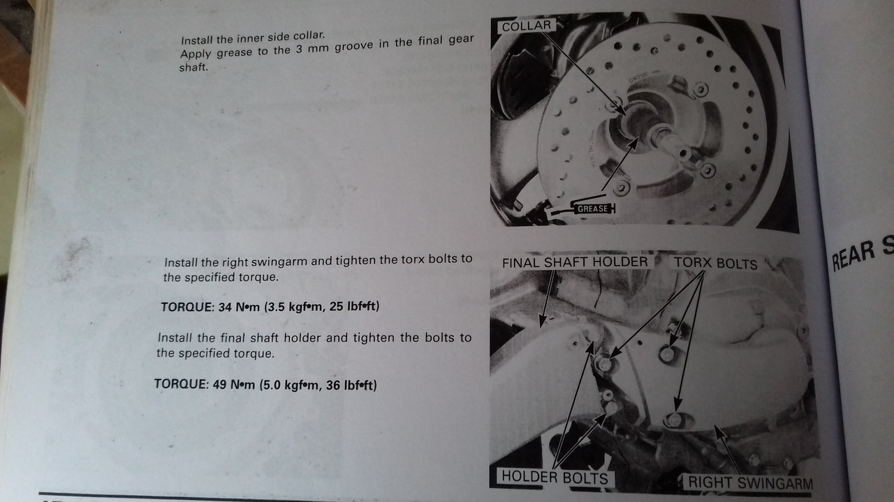

Thanks for your input everyone. I've gone with my regular multi purpose grease as that's all I have at the moment. The Wurth grease is available on Amazon so I think I'll invest in some for future use.
One thing is bothering me about the rear swing arm bolt torque spec though.
I have in my 'home made' reference manual that the rear swing arm bolts are torqued to 25lb/ft. I've done this job many times before but with my old age creeping in I'm thinking that it doesn't sound like a lot for a heavy duty piece of hardware. Can anybody confirm the torque spec for this?

Confirmed.
Rear Wheel Spindle Grease? Img_2811

Thank you Mike and John. 25lb/ft it is and a bit of grease on the splines.
BTW, the next line of text says 'install the final shaft holder...' what is that?
After installing the swing arm and axle nut the only things left are the brake calipers, the shock lower bolt and the plastic swing arm bolts cover. I'm curious!

What we are suffering from here is terminology, indeed the 'swingarm' torx headed bolts are torqued to 25 lb/ft, BUT what Honda call the 'swingarm' is the pivoting section that is connected to the engine, 'the final shaft holder' is the extension of the'swingarm' that supports the rear axle & has the brakes mounted on it, the torque setting for the hexagon headed bolts (later hidden under a plastic shield) is 36lb/ft

Thank you for clearing that up The Bern. It's the hexagon bolts I'm concerned with here as I had no need to remove the torx bolts. I must refer to it as the final shaft holder in future. It makes sense now.
I'd better get out there and torque them up to 36 not 25.They say curiosity killed the cat but it may have saved my life!
